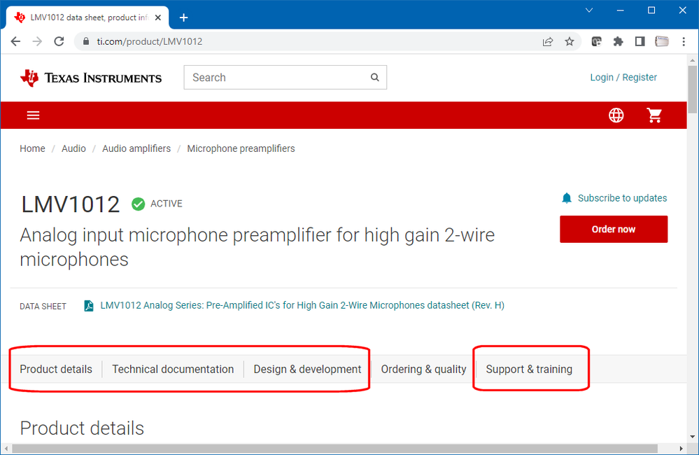

"I have found this preamp"
As for any component, Take a look at the support materials available on the manufacturer's website:
