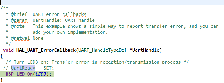

I am trying to communicate Uart in interrupt mode.We are able to successfully transmit & receive data to PC (through USB-UART).But when we connect to UART based modem then we are getting HAL_UART_ErrorCallback & transmission is failing. Pls help us.
‎2021-03-18 5:30 AM
This error callback function is not getting called when we connect to PC. But we are getting during modem (UART based)communication only. Whats purpose of this callback ? Is there any configuration need to add ?

I am trying to communicate with gsm module and it’s getting overrun error in TX call back function. Our uart transmit and receive line is 3.3 v ....We are setting converter for ttl match and result is same.
Please guide us how we can resolve this issue? We are using STM32F411VE discovery.

Thank you all for your response.
We have tried new interrupt based program and its working but we still see error and continuously UART error callback function (i.e. HAL_UART_ErrorCallback) getting called.
If this error is getting then we don't get any data in receive buffer. Please suggest us:
- How to handle this callback function so that it will clear and start receiving buffer again.
- How we can avoid this error ?
