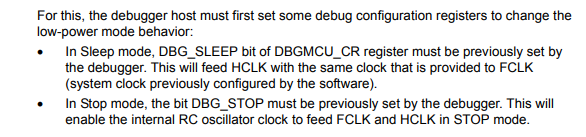

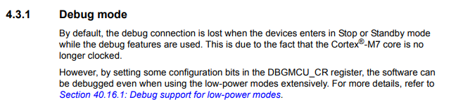

This indicates that the MCU has been reset (a hard fault probably). Could you clarify if you need to restart debugging or that you find yourself in the entry point after exit of the low power mode.
Otherwise, to answer you question here are extracts from the reference manual:

I solved the problem using STOP mode: HAL_PWR_EnterSTOPMode (PWR_LOWPOWERREGULATOR_ON, PWR_STOPENTRY_WFE);
Now MCU continue execute code from enter power down state.

Hello @Community member​,
For Standby and Shutdown we have a system reset after waking up, otherwise the other modes continue the execution.
