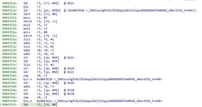

I call the touchgfxSignalVSync through a Timer Interrupt and quickly after I get an HardFault in the blitCopyARGB8888 function. As this is a library I cannot debug further. I am trying to go around the issue by increasing the stack size (24*3072 = 73728 bytes) but this does not fix the issue. Commenting the draw function in the touchgfxDisplayDriverTransmitBlock function does not help either.
Doing a step by step debug, I see that the load looks to be the issue where the address 0x2000cXXX is loaded.

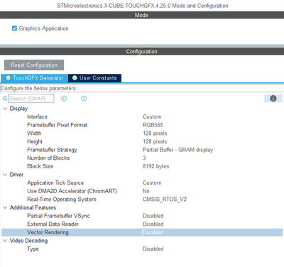

GaetanGodart
Hello @pokitoz ,
Can you try to set your "Number of blocks" in STM32CubeMX to 4 instead of 3?

pokitoz
Hello Gaetan,
Thanks for the reply.
I had to lower the buffer from 8K to 4K to use 4 buffers because of memory constraints.
However, I still get an issue:
Do you have a sample configuration using an external flash, STM32G0, CMSISv1 and Partial Frame buffer ?
