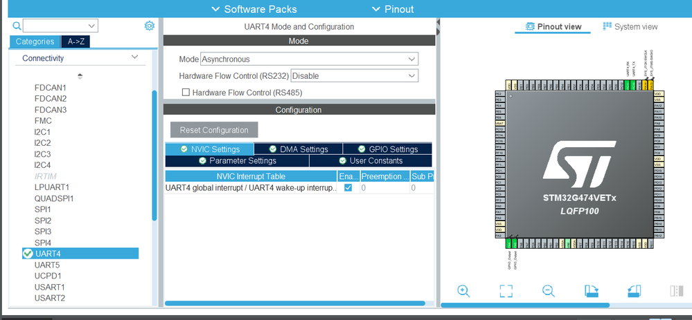

You still haven't indicated if you enabled the NVIC as suggested in a previous reply?

KaushikSTM32
sir,
Implemented and rechecked in blocking mode, Its working fine.
But facing the same problem with non blocking interrupt mode: when I entered a thing on serial terminal(putty) it got hanged and stopped my toggling also. code is attached.

Yes Sir, this one?
Screen shot
Attach your IOC file

KaushikSTM32
Yes sir, file is attached.
