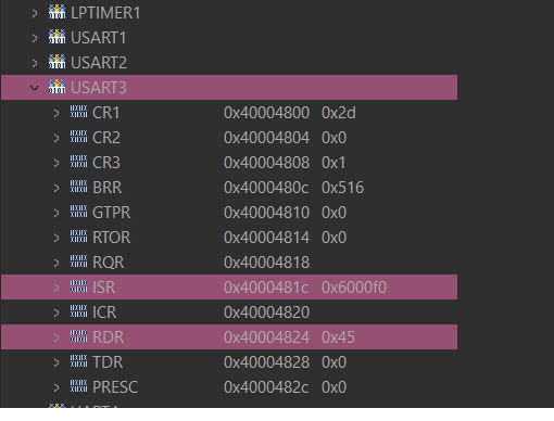

Sir,
I went further into it I had monitored the RDR and it showed the received value correct.
I also monitored RXNE flag it was setting at 1 while receiving the first byte.
And also RXNEIE is 1. Interrupt routine should be called but it reset RXNE and debugger got lost, not executing anything.
I have checked NVIC in startup file all seems ok.
