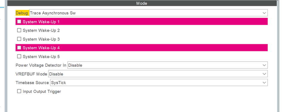

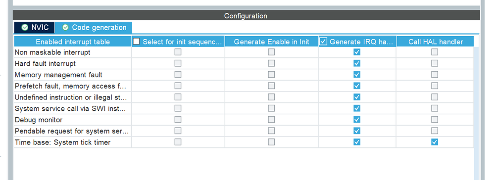

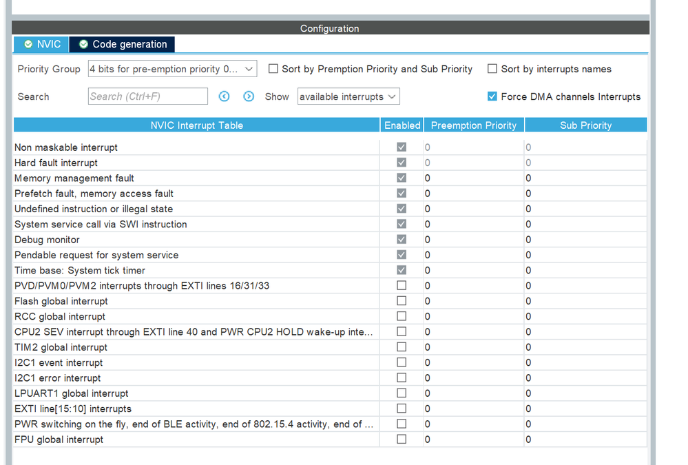

The Timebase Source is set to SysTick and see that SysTick->VAL register keeps changing, so I assume it is actually running.
I thought perhaps:
- the interrupt is not triggered
- or something incorrect in the clock configuration tab in CubeMX
But in CubeMX - in the three screenshots below - all the settings seem correct. So perhaps there are other settings I should look at, but if so I have no idea which ones and where?

Saket_Om
Hello @Ricko
Did you try enabling global IRQs in the code (e.g. using __enable_irq();)?
