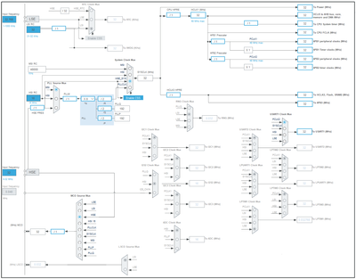

Together with a document I received from a colleague, I managed to get the TCXO going!
Drift is pretty much gone now: I only got 16ms drift over the course of 3600s.
18:57:14.177 > 0 18:58:54.176 > 1 19:00:34.176 > 2 19:02:14.176 > 3 19:03:54.175 > 4 19:05:34.175 > 5 19:07:14.175 > 6 19:08:54.174 > 7 19:10:34.174 > 8 19:12:14.173 > 9 19:13:54.172 > 10 19:15:34.172 > 11 19:17:14.172 > 12 19:18:54.171 > 13 19:20:34.171 > 14 19:22:14.170 > 15 19:23:54.170 > 16 19:25:34.170 > 17 19:27:14.169 > 18 19:28:54.169 > 19 19:30:34.167 > 20 19:32:14.167 > 21 19:33:54.168 > 22 19:35:34.167 > 23 19:37:14.166 > 24 19:38:54.166 > 25 19:40:34.165 > 26 19:42:14.165 > 27 19:43:54.165 > 28 19:45:34.164 > 29 19:47:14.164 > 30 19:48:54.164 > 31 19:50:34.163 > 32 19:52:14.162 > 33 19:53:54.162 > 34 19:55:34.161 > 35 19:57:14.161 > 36
View more
I will try and see if the logic proposed by @Tesla DeLorean makes it more stable - 16ms on 3600s is ~44ppm drift, ideally I'd get to half of it. But this is definitely usable!! Thanks everyone!
For anyone ending up here - see the attachment chapter 7.5 for the HSE/TCXO settings, and see my Clock configuration in the next image.
