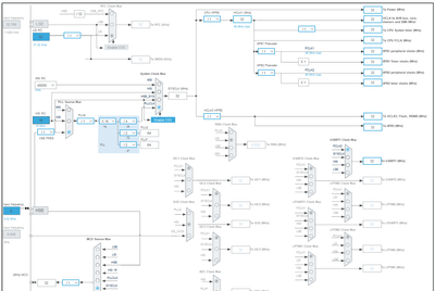

For completeness sake, here's a message of the Clock configuration (the bottom half outside the picture is all greyed out and as per default).

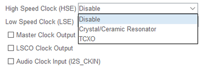

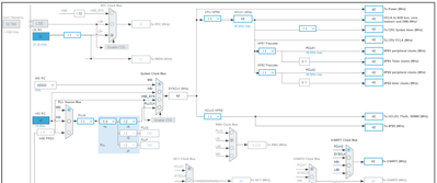

According to the Seeed wiki, the LoRa-E5 has a TCXO connected at 32MHz. After configuring that as the HSE source, I would like to use it as the clock source.
Would the following Clock configuration make sense, or would it likely result in troubles? My apologies - I don't really have a feeling for it yet, besides knowing that I can't really go below ~20MHz for CPU/SPI.
‎2024-10-15 7:02 AM
I don't know about that "TXCO" clock source.
To me the configuration is good but:
You need to ensure that this TXCO is available and generating a precise clock.
Otherwise, you need an external crystal with the config I mentioned above.
