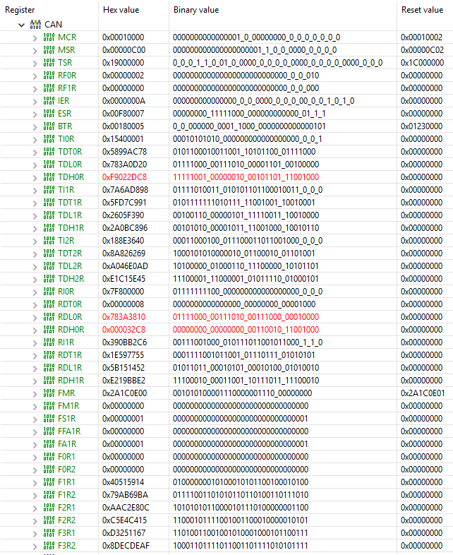

I'm using one STM32F2 board and two STM32F3 boards. The F2 is the CAN master and the F3 are slaves. Everything works fine if I use only one F3 board. If I add the other one, then after 30sec - 5min one of the F3 boards is going to always return HAL_TIMEOUT from HAL_CAN_Transmit.
This is the code from HAL_CAN_Transmit that always returns HAL_TIMEOUT.

Here is a snapshot of my CAN registers right before the return HAL_TIMEOUT;
2017-12-19 11:52 PM
The bug gets triggert if there is a collision on the CAN bus. eg. if two devices send a frame with the same CAN priority at the same time. This will permanently lockup the TX of one of the devices.

Hello
alexander.siebert
,The issue related to
HAL_CAN_Transmitis
already raised internally to our development team and we would inform you that there is a plan for 2018 to reworkHAL CAN driver.Thank you for your understanding.

its the same message ID issue.
different boards should use different message IDs
after a bus error like that, you have to power cycle all the boards.

I have a similar problem too, CAN-TX-TIMEOUT always occurs on the client. I've replaced the Cube-HAL (2.7.0) with the Keil-HAL (2.7.0) problem solved.
