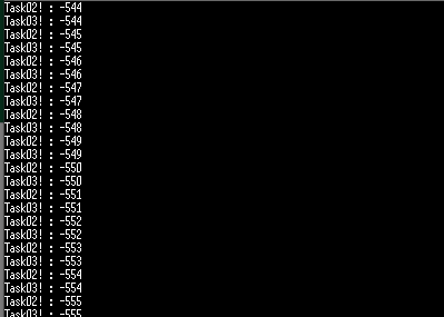

Hi, I'm trying to practice FreeRTOS with my STM32F769I-Eval kit.
I made two task with different priority and print global variable with semaphore.
When I run my code, terminal print decreased value every time.
I don't know why. Here is my code.

Please let me know why this starnge behavior happen.

Where is the rest of the code uses g_iCount?

Sorry, I didn't place my code. But I found the answer myself. I set the value to 0 in main instead out of main function. ​

After set the value in main function, It works correctly.

The task stack size of only 128 is probably too small. Especially because you’re using printf-family functions usually requiring much more stack.
You really should enable FreeRTOS stack checking and define configASSERT for development.
