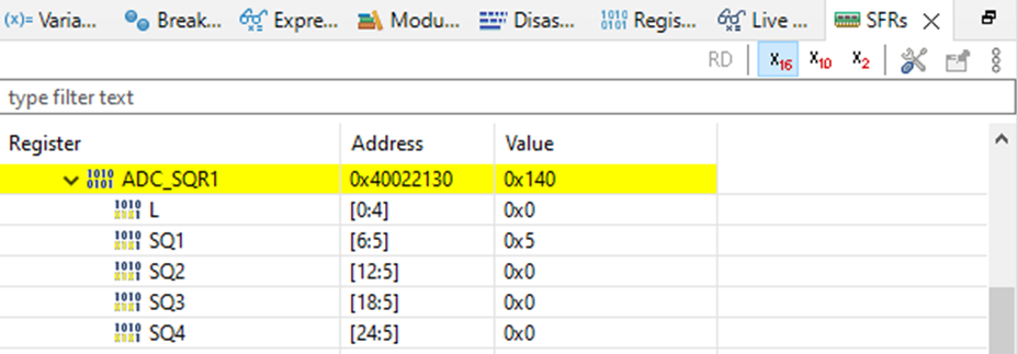

I made some tests with Nucleo-H723ZG and I didn't find any issue and I get ADC_SQR1=0x140.
0693W00000aItJ3QAK.pngI will check again with Eval board and I will get back to you as soon as possible.
Thank you.
Kaouthar

KDJEM.1
Hi @FBaev.1​ ,
> How exactly you obtained the ADC_SQR1=0x140?

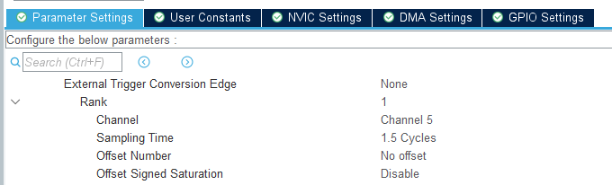

  • Enable the ADC1 with Channel=5 and Rank=1 with STM32CubeMx6.7.0 version.
  • Generate the code with LL using STM32CubeIDE 1.12.0.
  • Debug project and execute the code step by step.
  • Check the ADC_SQR1 register value in the SFRs. In this case the ADC_SQR1 =0x140.
The MODIFY_REG formula in the LL_ADC_REG_SetSequencerRanks() is
MODIFY_REG(*preg, ADC_CHANNEL_ID_NUMBER_MASK_POSBIT0 << (Rank & ADC_REG_RANK_ID_SQRX_MASK), ((Channel & ADC_CHANNEL_ID_NUMBER_MASK) >> ADC_CHANNEL_ID_NUMBER_BITOFFSET_POS) << (Rank ADC_REG_RANK_ID_SQRX_MASK));
Also with the STM32H757I-Eval board, with Channel=5 and Rank=1, the ADC_SQR1=0x140.
I hope this help you to solve the issue :) !
Kaouthar
