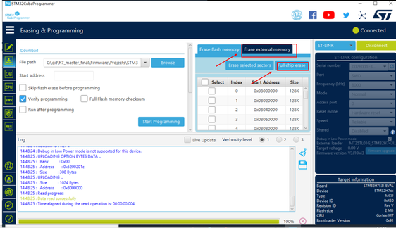

you can use STM32CubeProgrammer , it is an excellent tool for programming and erasing internal & external flash memory. Here’s how you can use it to perform a mass erase and format the external flash:
Download and Install STM32CubeProgrammer:
- You can download STM32CubeProgrammer from the STMicroelectronics website.
Connect Your Microcontroller:
- Connect your STM32 microcontroller to your PC using a USB cable or ST-LINK programmer.
Open STM32CubeProgrammer:
- Launch the STM32CubeProgrammer application.
Select the Target:
- In the "ST-LINK Configuration" tab, select the appropriate interface (e.g., ST-LINK, USB, UART) and connect to your target microcontroller.
Mass Erase:
- in the "Erasing & Programming" tab Select the "Full chip erase" option to perform a mass erase of the flash memory
