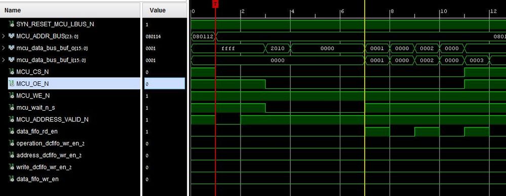

We access FMC PSRAM in 32-bits.
We noticed that although the access was expected to be in 32-bits (using HAL_SRAM_Read_32b) , CS signal is actually asserted for long of 64-bits!
Is there anything which can explain why the CS is twice the time of the expected access ?
This is the initialization of this interface of bank #3.
As you can see access is also using no wait signal:

Read access timing diagram:

The bus is 16 bits wide and you're doing a 32 bit access?​

mhhh , yes.
So, that's seems like a big error....
You present information through a key-hole making the complete context hard to understand or replicate properly.
The cited thread indicates you need to watch the MPU configuration so behaviour of the caching, write-buffering, etc the core is using don't cloud the interaction on the external bus.
The poster(s) there are trying to use simplistic memory-mapped hardware, where write-thru occurs immediately and in-order.
