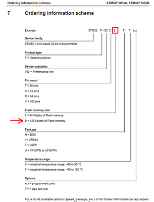

Hey everyone I have a qn freejoy.hex is 155kb and my stm32c8t6 is only 64kbs and 128kb how did yall get it flashed

Hex file does not reflect the real size of the application. It contains also the addresses: https://en.wikipedia.org/wiki/Intel_HEX
If your the generated binary exceeds the Flash size oh the MCU you beed to migrate to a bigger flash size device:

This is the size of the hex file need to convert it to bin format to know the real size of the application. If it exceeds 64kB there is no other solution than migrating to bigger flash size device of 128kB as I explained previously.
