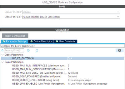

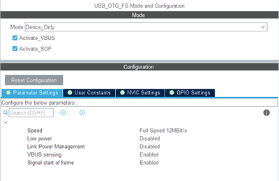

my project must acquire a ps2 keyobard and a ps2 mouse and must be see with the usb.
This is ioc configuration:

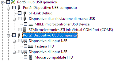

So I've try to combined the descriptors and the PC see the keyboard and mouse.

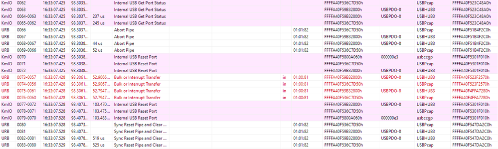

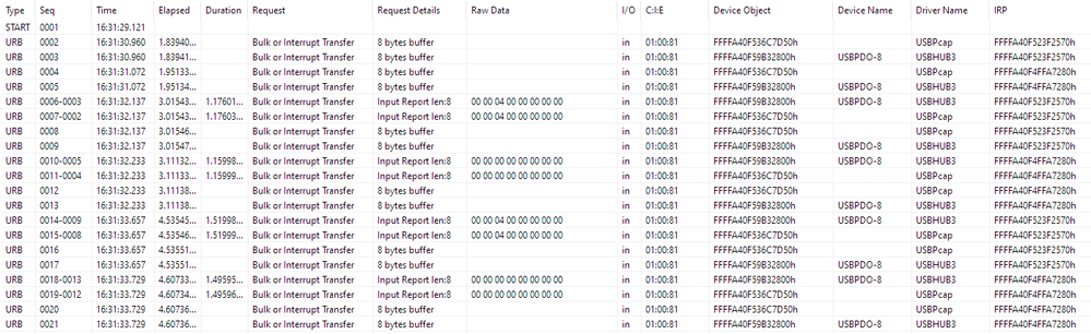

When I send the report of keyboard I'm able to write the character.
But when I send the report of mouse I see an "Abort pipe" and the usb crash.

About 10 years ago I did a similar thing on a STM32F4. Don't have sources but recall that the USB part of it was straightforward. Just make sure the HID descriptors are correct.
For the best compatibility (any old host) converters are composite devices with the keyboard as the 1st function.
But any modern desktop OS understands one device with two HID collections: two report descriptors in one HID device, one for keyboard another for mouse. Only one function descriptor and one endpoint.
