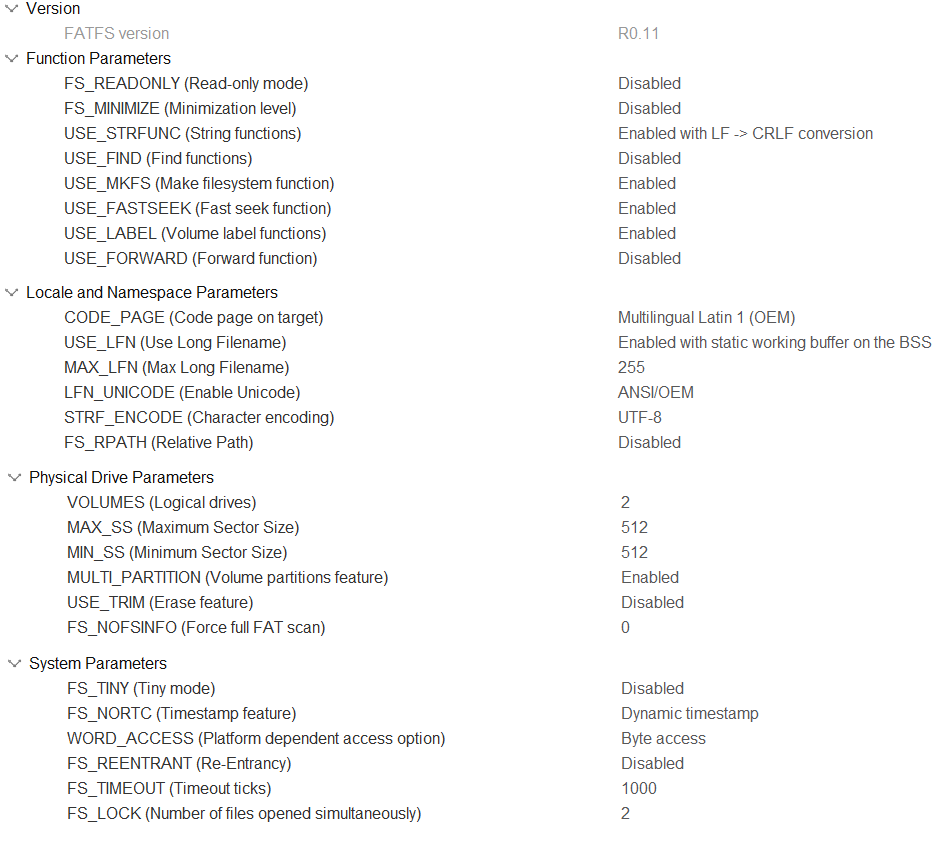

I am using FatFS on stm32f103RB MCU. I have a Single SPI bus and 2 CS pins for 2 SD Card.
used STM32CUBEIDE. No problem when I use 1 SD card and 1 CS pin. But Problem occurs when I use 2 SD Cards. Problem is SD Card 2 not mounting

I am using the "pdrv" parameter here for CS pin control. But "pdrv" parameter allway 0. For this reason, SD Card 0 remains selected.

my FatFS library parameters :
0693W00000ANnJXQA1.pngI will be very happy if you can help :)
Thanks..

You'll have to manage this, and the selection/deselection, in the DISKIO layer code.

Inside the discio.c file there is the "disk_initialize" function. The "pdrv" parameter here is always seen as 0 in debug mode. I've closed all the "fil0" and "fs0" related lines. I only worked with "fil1" and "fil2" but "pdrv" was 0 again. I was able to follow this parameter in the above f_mount function. The value that is 1 then changes to 0. as a result, I always read the value 0 in user-side functions.
DSTATUS disk_initialize (
	BYTE pdrv				/* Physical drive nmuber to identify the drive */
 DSTATUS stat = RES_OK;
 if(disk.is_initialized[pdrv] == 0)
 disk.is_initialized[pdrv] = 1;
 stat = disk.drv[pdrv]->disk_initialize(disk.lun[pdrv]);
 return stat;
