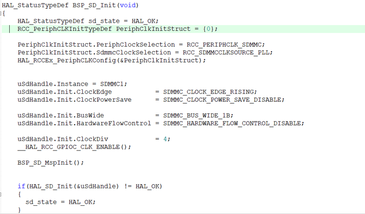

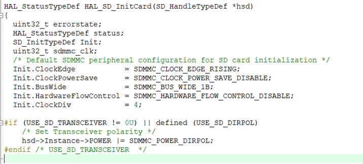

I am trying to program on keil based on sdio with STM32H753ZI MCU.
I am able to successfully initialize the sdcard FATFS_LinkDriver(&SD_Driver, SDPath),
and I use HAL_SD_Erase() to erase ,itˊs successful ,
but when i use f_mount() function it stuck in the disk_read() and doesnˊt return.
Here are the steps of these function:
f_mount()->find_volume()->chech_fs()->move_window()->disk_read().
here are my sd init parameters
What should I do to solve this problem,
Thanks!

2024-05-22 2:58 AM
>HAL_SD_Erase() to erase ,itˊs successful (How you know this ?)
So you at first try to destroy the filesystem on sdcard , and then -big surprise- you cannot mount ? :)
1. use a working card with fatfs (check in your PC first )
2. never write or format card, until mount and read is working fine .
3. try mount - until success, then go on...
fresult = f_mount(&SDfs, (TCHAR const*)SDPath, 1); // SD card mount NOW
2024-05-22 3:59 AM
As @AScha.3 stated, you should not "erase" the SDCard. If you do that, then you have to call f_mkfs.
You only "erase" the full media one time, says at the first time you use it, but not when using an SDCard. You usually format a Flash Memory, like a NAND or NOR Flash... Then you do f_mkfs to format the drive/memory and then you call f_mount to actually use the drive/flash.

2024-05-22 6:01 PM
Thanks,Ascha.3
Sorry,my description is not detailed enough.
I use SDFormatter.exe to format SD card on PC,after I use HAL_SD_Erase() to erase,
so when I use f_mount(),SD card is still fine.
Then I want to use f_mount() to mount the sd card,
the problem I mentioned occurred.(stuck in the disk_read() and doesnˊt return)
