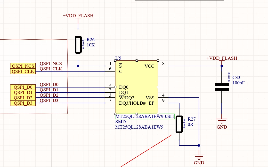

The connection of the flash chip to my STM32U599NJH6Q is like this:

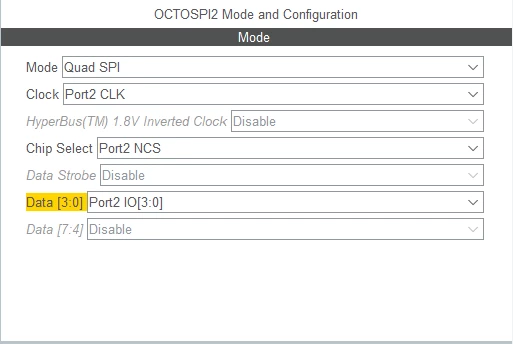

On the MCU side this corresponds to this configuration to the CubeMX:

Please enumerate the pin usage for this board, ie GPIO for CLK, NCS, D0..D3
Thanks a lot for you reply.
The pinout is:
NCS -> PA0
CLK -> PF4
D0 -> PF0
D1 -> PF1
D2 -> PF2
D3 -> PF3

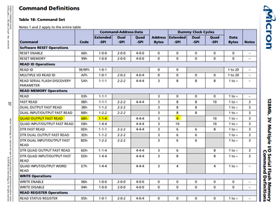

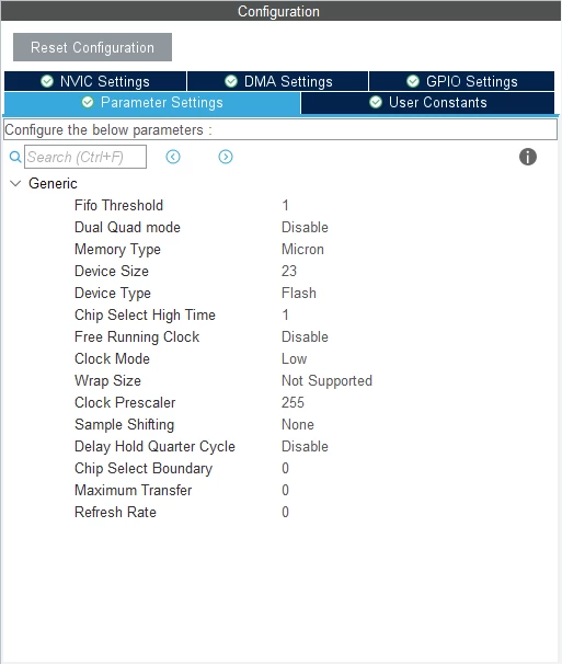

Could you please check the OCTOSPI configuration like as Devise Size, Sample shifting and Delay hold quarter cycle.
The size of the OSPI memory in bytes and expressed in 2^n. For 128MBits = 16Mbytes = 2^24. In STM32CubeMx, the device size field is set to 24.
Sample shifting (SSHT) recommended to be enabled in STR mode and disabled in DTR mode.
Delay hold quarter cycle (DHQC) enabled in DTR mode and disabled in STR mode.
Also could you please refer to memory datasheet and check the dummy cycle required for read and write operation.

Previously I had the device size set to 23. I was under the impression that it needed to be 2^(n-1). Anyway, I have changed it now.

Could you please check the Dummy cycle. I noted in the driver code "qspi_flash.c" specifically in the the function "CSP_QSPI_EnableMemoryMappedMode(void)", the command-address-data is set to 1-1-4 which is for extended SPI, and dummy cycle set for 10 in "qspi_flash.h" , which is intended for Quad SPI mode as mentioned in the memory datasheet. However, according to the datasheet, dummy cycle configuration for extended SPI should be 8. Therefore, I suggest changing the "DUMMY_CLOCK_CYCLES_READ_QUAD" to "DUMMY_CLOCK_CYCLES_READ" = 8 in the "qspi_flash.h".
Thank you.
