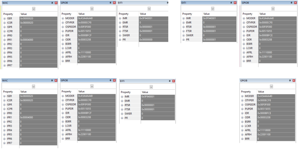

Here are the registers as requested. Top row is of the non-bootloader version. Notice the fourth (left to right) has the PR bit 0 set. The rightmost one is the corresponding GPIOB. Taken after a breakpoint stop on the ISR entry when button was pressed.
Bottom row is the same registers for the bootloader version. The rightmost image is of the GPIOB when I press the button (notice the bit 0 of IDR goes to zero). PR bit 0 never is set.
Maybe it is sheer fatigue but I simply cannot find any difference in the configurations that could justify the behavior.

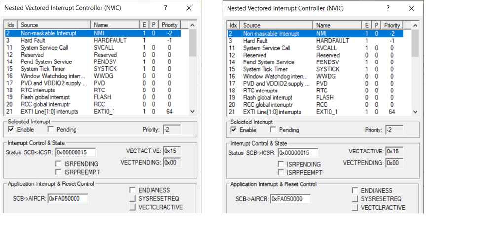

Below, the core NVIC view of Keil, left the non-bootloader version, right the bootloader one.
What am I missing?
waclawek.jan
Compare also SYSCFG_EXTICRn.
> RCC_APB2PeriphResetCmd(RCC_APB2Periph_SYSCFG, ENABLE);
I don't use SPL, but RCC_APB2PeriphResetCmd() does not sound that it's intended to *enable* anything. Doesn't it leave the respective RCC reset bit hanging at 1?
Hello, Jan.
Thank you for chiming in.
You're right, SYCFG_EXTICR1 is different, 1 in the working version, 0 in the BL version.
And yes, the SYSCFGRST bit is set when it enters the application and it is never reset; therefore the configuration on SYSCFG_EXTICR1 is never set.
