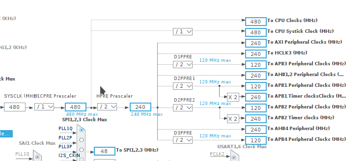

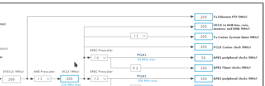

However, System time seconds register (ETH_MACSTSR) does not count and just loaded initial value in System time seconds update register (ETH_MACSTSUR). In reference maual there is no clear information about clock source for PTP. In STM32F7, there is a clock path for PTP as in image below in CubeMX clock configuraton page.
However there no clock path for PTP in STM32H7 as in image below.
Am I missing something about to get system time from the registers ETH_MACSTSR and ETH_MACSTNR ?

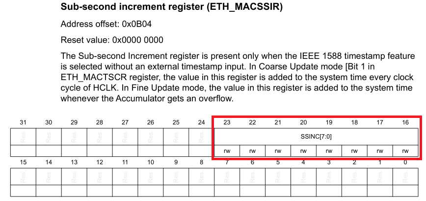

The problem comes from the Sub-second increment register (ETH_MACSSIR). The value to be incremented is stored in high word of the register as in the image below.
Everything runs as expected when changed the value as follow.
WRITE_REG(heth->Instance->MACSSIR, ((uint32_t)20)<<16);
