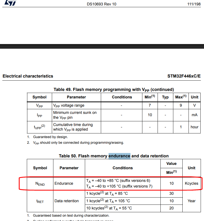

Another issue you need to consider is that of Flash wear.
Erasing flash does cause wear; ie, it degrades the memory's ability to store data
This is specified in the datasheet as endurance:
https://www.st.com/resource/en/datasheet/stm32f446re.pdf#page=112
What that means is that, once you've erased a sector 10k times, ST no longer guarantee that it will continue to store data.
So one of the things that the EEPROM emulation does is wear-levelling - to minimise the number of erase cycles.
This is something you will have to consider, whatever you do ...

JJoao.1
Ok, I'm a little confused.
To resume what I understood /
Only an entire sector can be erased. So If I want put my data at the end, I should use and erase the 128kB.
It's not a very big problems, but It's just a lot for only a few bytes. Why not....
