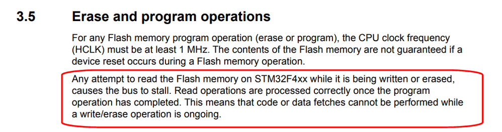

And you will invariably come across another term (and problem) related to Flash - the "bank".
All sectors in one Flash bank can only be set to programming mode at once(especially, applying programming voltage internally). And you cannot execute code from a Flash bank while under programming voltage.
Most MCUs are single-bank designs. This means, you either accept to stall during the actual flash programming, or run the flashing code from RAM.
An alternative solution is a cheap external EEPROM (I2C or SPI).
Andrew Neil
April 23, 2025
@JJoao.1 see the RM:

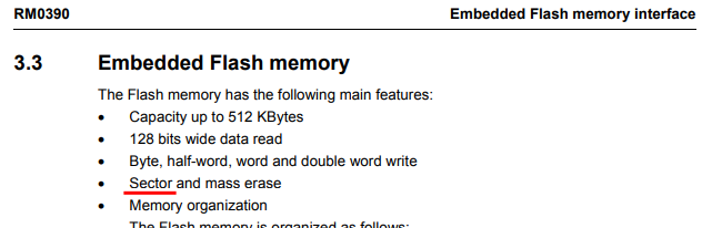

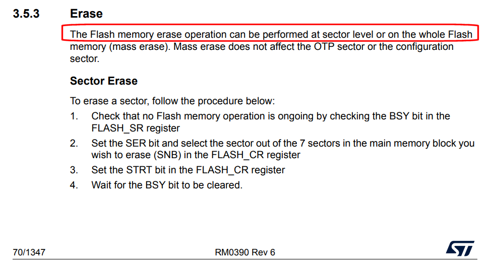

Andrew Neil
April 23, 2025
@Hl_st wrote:
Yes, you can erase only 2 kB on sector 7 at the address 0x807F7FF.
Really?
Surely the whole point of the "Sector" is that it defines the size which can be erased? You can only ever erase a whole sector - not a part thereof.
Surely, that's what the RM means by, "Sector erase":
And, explicitly:
@Hl_st wrote:
 Try to follow the example I have send in my last reply there is also erased only 2 kB.
But that is for an entirely different processor

Andrew Neil
April 23, 2025
@JJoao.1 wrote:
Only an entire sector can be erased.
Correct.
@JJoao.1 wrote:
So If I want put my data at the end, I should use and erase the 128kB.
Yes: the last sector is 128K - so, if you want to use that one, then that's the one you have to erase.
