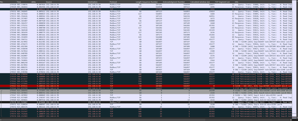

Hello there,
i have some connection/re-connection problems with my opcua server, when i unplug the LAN cable.
Because of prevent memory problems i disable the most Options for the opcua Server. Perhaps in the Future i will try more options out.
But at first the Connection should be stable and when I unplug the LAN cable a re-connection should be possible again.
Perhaps you can help me here.

JonasReich92
Hi, thank you for your replies.
I need to use LwIP to get open62541 working and it is necessary.
The connection problems come up when I have a open port. For OPCUA for example it is the 4840 - here i cannot reconnect again after cable disconnect, but with modbusTCP i have the problem after the 3 cable disconnect - here i have setup a workaround in my application to disconnect the socket when this happend and with this workaround i dont have the problem anymore.
But with the opcua its very difficult to find a workaround in the same way and i dont want to change to much in the open62541 stack.
When the bug is so well known, perhaps you have some helping links to good description of this bugs and the discussions  @mbarg.1
Sry but the "forum search" don't help me very much. @Andrew Neil

4.Solution - I add some Timeout Handling to the Modbus TCP and OPC UA to free my lwip rescource to start a new connection when it is necessary - This looks very good.... At First.
But this only make a different Problem occur.
I think this a unique one - Because I have very lot of Data and Task which block my Controller Resources.
Now the Connection dont work any more after a sporadic time and ONLY when i pull the Cable - wait 5-10sec - attach it again.
For Example the Test Sequence:
1. Start the DUT
2. Connect Modbus TCP (do some Communication, i poll some Input register very fast for 8ms)
3. wait 1-2 minutes
4. pull the Cable - wait 5-10sec - attach it again - do this 2-3 times
5. wait now 10 minutes
6. When the Connection works fine pull the Cable - wait 5-10sec - attach it again - do this 2-3 times
7. wait now 10minutes
8. The Error can occurs sporadic.
 This can i retry a lot of times, but the Error can occurs on a sporadic time.
It looks like in the ethernetif.c, which was generated with STM32CubeIDE trigger this Problem.
 * @brief Should allocate a pbuf and transfer the bytes of the incoming
 * packet from the interface into the pbuf.
 * @PAram netif the lwip network interface structure for this ethernetif
 * @return a pbuf filled with the received packet (including MAC header)
 *         NULL on memory error
static struct pbuf * low_level_input(struct netif *netif)
  struct pbuf *p = NULL;
  if(RxAllocStatus == RX_ALLOC_OK)
    HAL_ETH_ReadData(&heth, (void **)&p);
  return p;
What exactly TRIGGERS the situation when pulling cables? Flow example:
Link Up → Burst an ARP / DHCP / mDNS if applicable.
Very fast input several frames → Rx DMA, for example, 8–10 buffers → pool (12) are almost empty.
One or two more frames → alloc fails → RX_ALLOC_ERROR.
At the same time, your input task may still be in initial processing or is currently waiting for RxPktSemaphore.
Because of if(RxAllocStatus == RX_ALLOC_OK) it will NOW NOT be picked up any further → the time when the older buffers could come to the stack and be released later will be postponed.
Only when lwIP (TCP/IP Thread) releases the buffers that have already been passed on will your pbuf_free_custom() reach the code path again that sets RxAllocStatus to OK and posts Semaphore. T
This happens “sporadically” – depending on stack load, offload, timer run.
Cable pulling itself does not directly create the error, but rather increases the time window between feeding (frame burst) and processing.
Why doesn't it happen:
Because at some point you will ultimately get pbufs free (TCP/IP stack releases them → custom free → reset flag). The mechanism recovers – but with latency and unclean pattern.
5. Solution:
  return p;
In Conclusion:
Perhaps this Problem occurs only because on my Sytem, because i use a lot of Resources of the Controller and poll with some data with 8ms on ModbusTCP.
When you have some Re-Connection issues perhaps try my Solution 5 without:
Perhaps this Whireshark section helps to understand:
