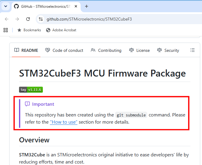

I cloned the repository https://github.com/STMicroelectronics/STM32CubeF3.git
but importing the project ...\STM32F3-Discovery\Examples\BSP
some code is missing in particular the code to manage the BSP device on the STM32F3DISCOVERY BOARD.
What I am missing?
Thanks in advance
Adriano

I suppose you cloned the github link without the recursive option.
Please refer to this article: Downloading STM32Cube packages from GitHub correctly

As @Saket_Om said, did you follow the download instructions:

You can also download the ZIP package directly from the STM32CubeF3 package on st.com.
