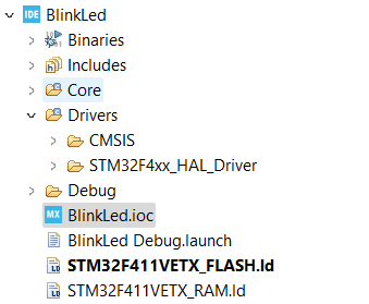

Hello @studentof and welcome to the community,
You have two projects in the zip file you attached:
And the Drivers folder has "BSP" folder:
Not clear how that was generated by CubeIDE? did you copy and did some changes in the folder structure?
I've attached a project where 4 user LEDs are toggling. No need to add BSP or other stuff.

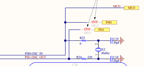

You've mentioned that the LED only blinks in HSI. Go back to using HSE and use an oscilloscope to verify if you see clocking on PH0 pin of the STM32.
Also make sure R25 and R24 resistors are in place.

Hi @studentof
About your observations :
  1. The clock configuration function SystemClock_Config() hangs if I select the external crystal (HSE).
    FBL_0-1755099987782.pngmake sure your HW setup is properly configured: Check SB14, SB16 OFF  –  R25 ON – R66 OFF
  2. The project only blinks the LED successfully when I disable USB_OTG_FS and switch to the internal oscillator (HSI). When USB_OTG_FS is enabled, I cannot select HSI as the PLL input because the MX requires HSE for USB. Disabling USB_OTG_FS allows me to select HSI and blink the LED.
