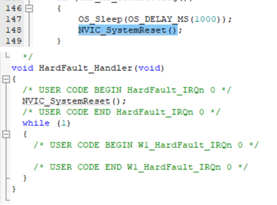

When I calling NVIC_SystemReset() in the os task, the system will enter into hard fault handler error, so I have to call NVIC_SystemReset() again in the HardFault_Handler() to reset the system, so what is the proper way to call NVIC_SystemReset() in the os task?
Pavel A.
Do your RTOS tasks run in non-privileged mode? Then of course NVIC_SystemReset() will cause a fault.
Maybe, do this in SVC handler and make the task execute SVC. Or just leave it as is.

NVIC_SystemReset() is one correct way to reset the chip.  Calling this from a task as opposed to the main thread should not cause issues.
If a hardfault occurs, I recommend finding the root cause and solving that. STM32CubeIDE has a hard fault analyzer that could be used.

As @TDK said, you should find out what's causing the Hard Fault:
Debugging Cortex-M Hard Faults

Yes, you are right. The os task is running in the non-privileged mode. As the OS has taken over the SVC_Handler, I configured the OS task to run in Privileged Mode instead.
Thank you for the help.
The root cause of hardfault is "Precise Data Bus Error", and the BFAR register is 0xE000ED0C which is SCB->AIRCR register (the reset register).
The root cause of my problem is that I run NVIC_SystemReset() under non-privileged mode, so I change the task mode to privileged mode to solve this problem.
