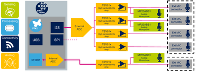

Hello ST team,
I am using Nucleo H753zi board, and I wanted to use X-CUBE-MEMSMIC1 expansion for sound source localization.
I have already designed simple PCB to use MEMs microphone and connect it to H7 board's ADC. I want to understand how I can program my board to use 4 mics- GCC-PHAT algorithm to get location of sound source.
I have gone through UM2212 and UM1901. Due to lack of experience in this field, can you guide me through how I can use this X-CUBE-MEMSMIC1 expansion for sound source localization? I found this diagram helpful and would like to understand how should I code to feed data from cache to Acoustic SL for processing.

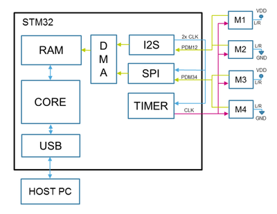

So, lets talk about X-CUBE-MEMSMIC1, focusing on Acoustic_SL example for NUCLEO-F401RE. You can easily go through the source code. You’re free to use the compiled library either importing the AcousticSL.c source file.
The initialization procedure is invoked in main.c with the Audio_Libraries_Init() function.
Then, each 1ms, AudioProcess is called. Basically, AudioProcess is called when 1ms of audio data are available. The example is based on 1ms tick, and during this period there’s PDM to PCM conversion, source localization input, and USB streaming.
Furthermore, the example implements software interrupt routines: once the source localization library has the new input, it starts calculating the angle. AcousticSL_Process will return the estimated angle.
What you need for your application is:
  • Set up the library with the proper parameters in base of your specific application (that is: number of microphones used, number of audio samples to process, sampling frequency, ...)
  • Feed the library with the right audio input: in base of the channel_number and ptr_Mx_channels values, the library is expecting data are distributed in arrays. In our example, audio data are available into a unique array in interleaved fashion (that is: s1mic1|s1mic2|s1mic3|s1mic4|s2mic1|s2mic2|s2mic3|s2mic4|... where s stands for sample).
  • How often are you receiving data from ADC? If you can set up your ADC to have data each 1ms, you can reuse the same approach as the original code.
Consider also that everything can work properly only with a continuous data stream at a fixed sampling frequency.
