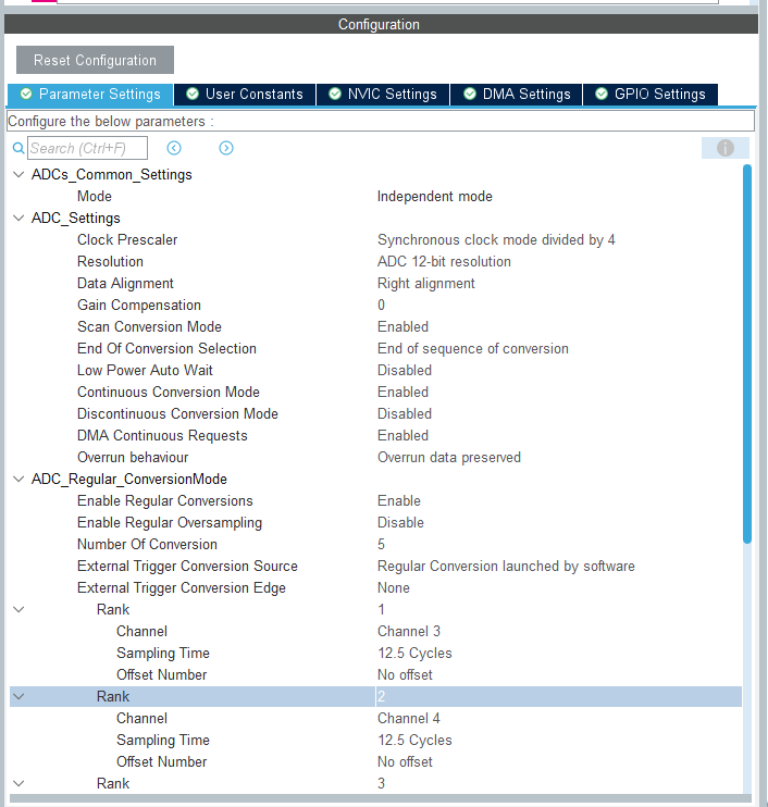

I am currently working with the STM32G431CBT6 and designing a custom ESC using the DRV8301 gate driver. My application requires a total of 9 ADC channels:
  • ADC1 → 4 channels
  • ADC2 → 5 channels
I configured both ADCs in independent mode with DMA (circular) using STM32CubeMX.

The cpu is too busy with the interrupts generated by ADC1 to progress any further in the code.
Reduce the sample rate by increasing the sampling time or having a timer trigger it.
Debug the code and hit pause when it's "stuck" to see where execution is. Likely it's within an interrupt.

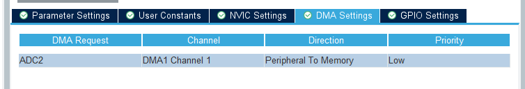

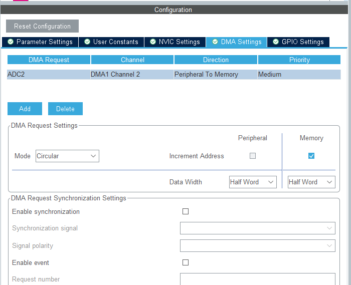

Disable ADC1 and let ADC2 working, what happens?
You didn't show the DMA settings of DMA2 in CubeMx. Did you configure it?
I tested the system using ADC1 only, and it worked perfectly. However, when I disabled ADC1 and enabled ADC2, the program gets stuck.
Previously, I implemented a bare-metal solution where both ADC1 and ADC2 were configured (even running together), and that setup worked without any issues.
Now, using the HAL library, ADC2 is not functioning correctly and causes the system to hang. I’m trying to understand why this issue occurs with HAL, while the same configuration works fine in bare-metal implementation.
