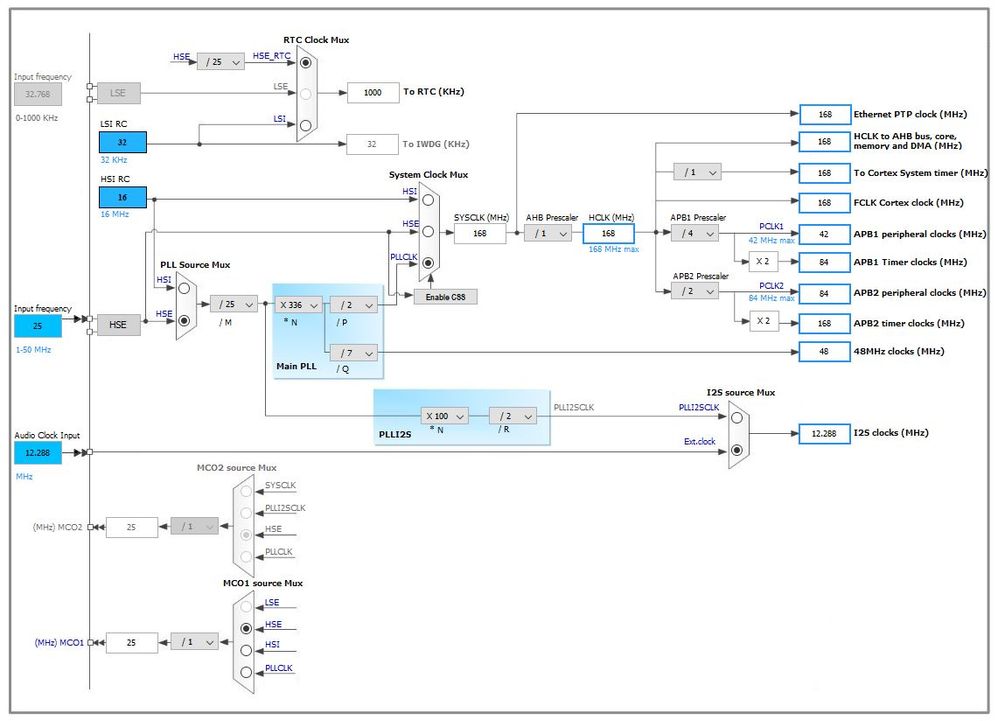

I have a project generated by &sharpSTM32CubeMX 4.25.0 using firmware STM32Cube FW_F4 V1.21.0. The clock configuration can be found in the attached picture below. When I debugged the generated  code I have seen that I2SSRC bit in RCC_CFGR register was not set to 1; which causes I2S malfunctioning.   0690X00000604WZQAY.jpg Here is the code generated by CubeMX:I have a project generated by &sharpSTM32CubeMX 4.25.0 using firmware STM32Cube FW_F4 V1.21.0. The clock configuration can be found in the attached picture below. When I debugged the generated  code I have seen that I2SSRC bit in RCC_CFGR register was not set to 1; which causes I2S malfunctioning.   0690X00000604WZQAY.jpg Here is the code generated by CubeMX:I have a project generated by &sharpSTM32CubeMX 4.25.0 using firmware STM32Cube FW_F4 V1.21.0. The clock configuration can be found in the attached picture below. When I debugged the generated  code I have seen that I2SSRC bit in RCC_CFGR register was not set to 1; which causes I2S malfunctioning.   0690X00000604WZQAY.jpg Here is the code generated by CubeMX:I have a project generated by &sharpSTM32CubeMX 4.25.0 using firmware STM32Cube FW_F4 V1.21.0. The clock configuration can be found in the attached picture below. When I debugged the generated  code I have seen that I2SSRC bit in RCC_CFGR register was not set to 1; which causes I2S malfunctioning.   0690X00000604WZQAY.jpg Here is the code generated by CubeMX:

Hi
metecantimur
Could you please precise on which device you have found the issue. So, we can verify it.
Best Regards,
Imen
Thanks
Imen
Mete C.
Posted on April 04, 2018 at 10:32
Hi
DAHMEN.IMEN
I am using STM32F407ZGTx MCU device in an proprietary board.
Best Regards,
Mete
Mete C.
Posted on April 04, 2018 at 16:44
Hi
DAHMEN.IMEN
I have the following workaround steps for the problem:
1) Insert the following line into the function
HAL_I2S_MspInitjust before the line containing __HAL_RCC_SPI3_CLK_ENABLE();
/* BUG FIX: Enabling Audio Clock Input in CubeMX does not set I2SSRC bit
* in RCC_CFGR register! Hence we need to set it manually here! * WARNING: A bug fix is also needed in __HAL_RCC_GET_I2S_SOURCE() */
__HAL_RCC_I2S_CONFIG(RCC_I2SCLKSOURCE_EXT);
2) Apply the following patch to the following macro in library the file 'stm32f4xx_hal_rcc_ex.h' at line 6112:
#define __HAL_RCC_GET_I2S_SOURCE() ((uint32_t)(READ_BIT(RCC->CFGR, RCC_CFGR_I2SSRC)) >> RCC_CFGR_I2SSRC_Pos) /*BUG FIX: MC*/
Note: I will report the bug in filestm32f4xx_hal_rcc_ex.h
at line 6112 as a new bug report.
Best Regards,
Mete
