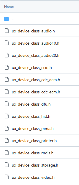

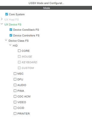

I would like to use USBX to make a CDC ECM USB device, but in STM32CubeMX, there is no option for CDC ECM or RNDIS in the USBX device class menu:

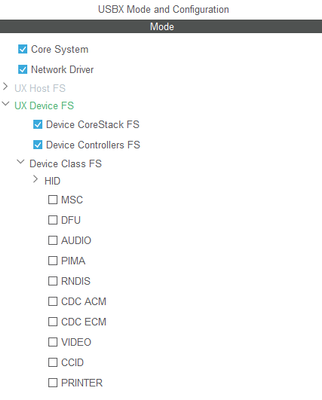

The STM32U545RE on the other hand has options for CDC ECM and RNDIS:
Does STM32U385 support CDC ECM and RNDIS with USBX? If yes, is there something I need to do in order to show CDC ECM as an option in STM32CubeMX?
Thanks!
KDJEM.1
Hello @wmcgsandc and welcome to the community,
The middlewares of STM32CubeU3 firmware supports CDC ECM and RNDIS with USBX.
I reported this issue internally to STM32CubeMX team for checking and fixing.
Internal ticket number: 216534 (This is an internal tracking number and is not accessible or usable by customers).

KDJEM.1
Hello @wmcgsandc ;
The issue is fixed in STM32CubeMX 6.16.0 version.
Thank you.
