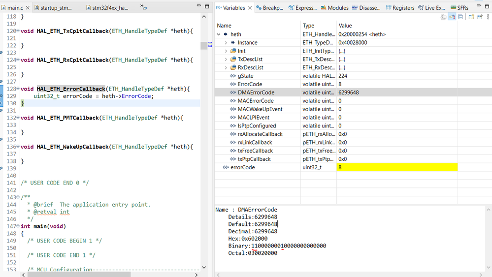

I found a bug when I enabling the ETH perpherial in the STM32F407 processor. The error is a DMA bus error.
What's happening:
It occurs when the ethernet PHY recieve a message from my router.
How to produce the error:
I do the following steps to reproduce the error.
  1. I start up my PCB board
  2. I let the initialization do its job and I get no error back.
  3. I plugin my ethernet cable
  4. I ping a random device with a random number
Then this call back function HAL_ETH_ErrorCallback(ETH_HandleTypeDef *heth); will be called.
0693W00000LyBzOQAV.pngThe error code is a DMA error.

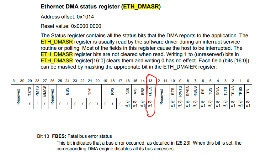

The DMA error is a DMA bus error.
0693W00000LyC0HQAV.pngThis part of the code creates the DMA error code. See the arrow <---- HERE!
/* ETH DMA Error */
  if (__HAL_ETH_DMA_GET_IT(heth, ETH_DMASR_AIS))
    if (__HAL_ETH_DMA_GET_IT_SOURCE(heth, ETH_DMAIER_AISE))
      heth->ErrorCode |= HAL_ETH_ERROR_DMA;
      /* if fatal bus error occurred */
      if (__HAL_ETH_DMA_GET_IT(heth, ETH_DMASR_FBES))
        /* Get DMA error code  */
        heth->DMAErrorCode = READ_BIT(heth->Instance->DMASR, (ETH_DMASR_FBES | ETH_DMASR_TPS | ETH_DMASR_RPS)); <<--- HERE!
        /* Disable all interrupts */
        __HAL_ETH_DMA_DISABLE_IT(heth, ETH_DMAIER_NISE | ETH_DMAIER_AISE);
        /* Set HAL state to ERROR */
        heth->gState = HAL_ETH_STATE_ERROR;
      else
        /* Get DMA error status  */
        heth->DMAErrorCode = READ_BIT(heth->Instance->DMASR, (ETH_DMASR_ETS | ETH_DMASR_RWTS |
                                                              ETH_DMASR_RBUS | ETH_DMASR_AIS));
        /* Clear the interrupt summary flag */
        __HAL_ETH_DMA_CLEAR_IT(heth, (ETH_DMASR_ETS | ETH_DMASR_RWTS |

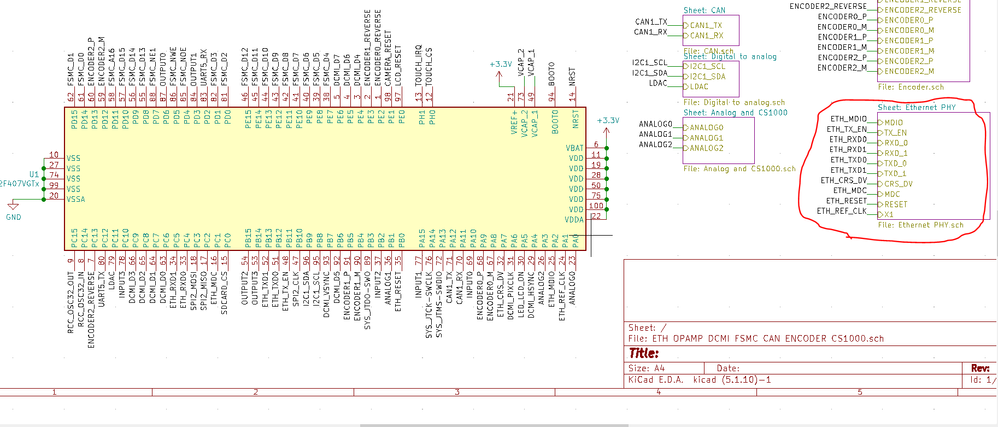

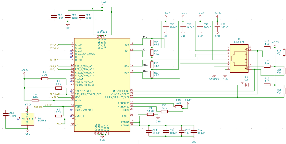

Hardware settings
The hardware settings are for RMII for the Ethernet PHY DP83848 .
Yes! The LED D1 flashes when something happen at the network. The pin ACT_LED/COL should go low when something happens. The oscillator is at 50 MHz and very close to the DP83848 chip.

Schematic project (KiCAD):
https://easyupload.io/9x3xig
Why I'm thinking this be a bug?
Because I have not configured ETH DMA and it give me a bug about that when my Ethernet PHY got a message and pass it over to the STM32 processor. I assume that STM32CubeIDE 1.9.0 have some issues then.
What am I 100% sure that I have been constructed the hardware correctly?
The Ethernet PHY address is 0x1 and I have been veryfied that this is correct address. The LED D1 is flashing when activity occurs at the network.
The callback function calls when the LED D1 flashes after initialization.

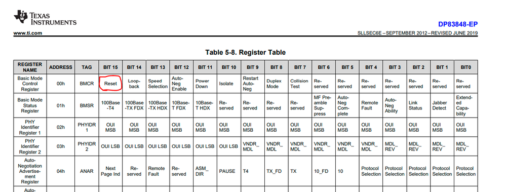

I found an issue now. This function calls with DevAddr = 0x1, RegAddr = 0x0 and RegVal = 0x8000 which means that RESET is called. That's correct. But this function ONLY calls at the start of the ST-controller. Otherwise...the function is not called any more during the run.
  * @brief  Write a value to a PHY register through the MDIO interface.
  * @param  DevAddr: PHY port address
  * @param  RegAddr: PHY register address
  * @param  RegVal: Value to be written
  * @retval 0 if OK -1 if Error
int32_t ETH_PHY_IO_WriteReg(uint32_t DevAddr, uint32_t RegAddr, uint32_t RegVal)
  if(HAL_ETH_WritePHYRegister(&heth, DevAddr, RegAddr, RegVal) != HAL_OK)
    return -1;
  return 0;
