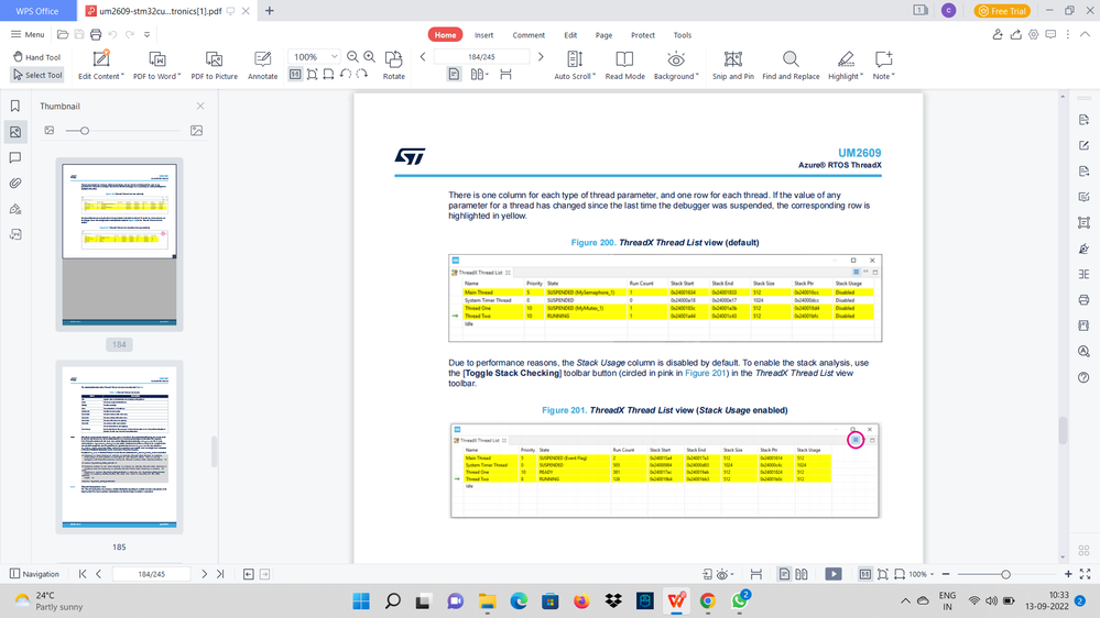

To know how much of stack is consumed,by my code and if i make any changes in my code how much of memory do i need ?
and here in the figure we are not able to view the below listed content and also let us know how to enable the ThreadX list.

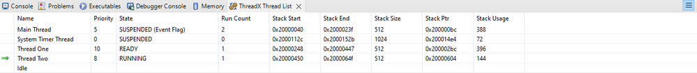

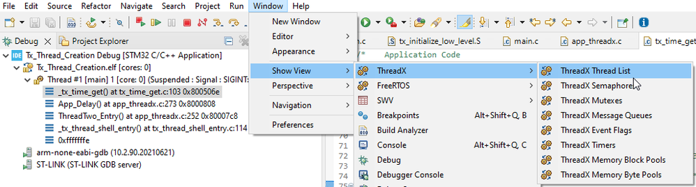

after starting the debugger you can access the ThreadX list as shown below:
notice that you need to pause the debugger to see updated infos, they are not update on runtime.
Hope this helps.
