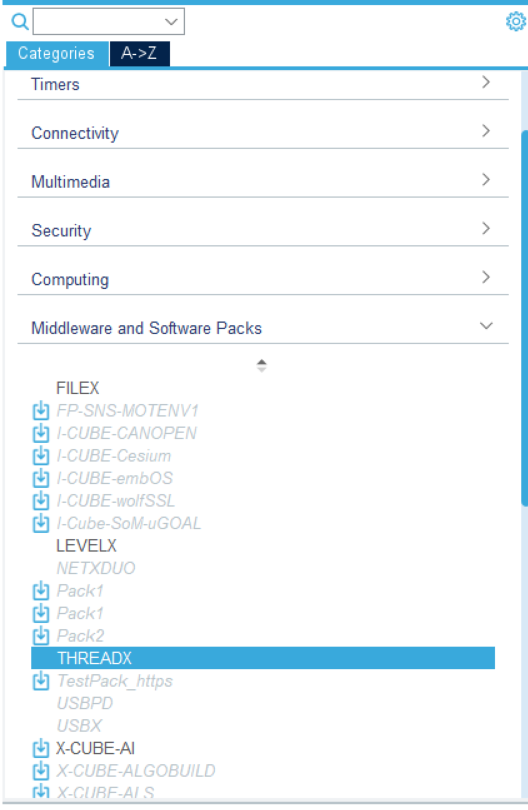

I am looking to use AzureRTOS on the STMH563 devices but it does not appear to exist for the STMH5 series. Is there a workaround for this? i.e. use the STM32L5 one?

Hi @ElecDesigner​ , AzureRTOS is natively integrated in CubeMx For STM32 new product (U5/H5/WBA /C0 ...). , you can fin auzure rtos components under middleware and software packs
