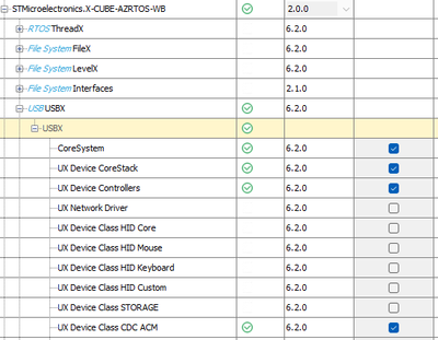

I only used X-CUBE-AZRTOS-WB and desactivated USBX :st3.png

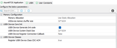

 Using buffer <10*1024 would rise a memory error flag in ux_device_stack_initialize() :
The rest is default configuration.

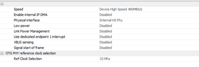

Then USB_OTG_HS : Device_Only and :

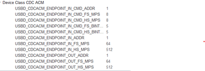

The point is : by default in X-CUBE-AZRTOS-WB we have this :
 and if i undestood corectly, ENDPOINT_IN_CMD_ADDR should be different of IN and OUT ADDR.
So i just modify like it :
USBD_CDCACM_ENDPOINT_IN_CMD_ADDR 2
And then it worked.
