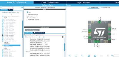

I am running an application with Azure RTOS, and CAN bus.  All was well until I needed to increase the tick time to 2000/second (from 1000/second).  When I did this the CAN Interrupts stop working. To make things even worse, when I change the tick time back to 1000/sec within CubeIDE, it still doesn't work and I have to pull and older version off Github to get it going again.  I'm not overly familiar with Azure RTOS, usually I just do my own OS.  CAN interrupts are priority 0, RTOS 15.  TIM6 is used for tick for RTOS.

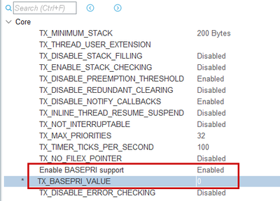

Hi @Rob Ashworth
Try to configure ThreadX to use the BASEPRI register, as shown below:
set the 'TX_BASEPRI_VALUE' to a value different from 0, then the CAN interrupts won't be masked.
regards
Haithem.
All fixed.  Fault was nothing to do with the Azure RTOS settings.  For some reason the .ioc file was setting the number of CAN filters to 0.  When I did a compare, it showed it up. Thanks for the pointers all those who contributed.
  hfdcan1.Init.StdFiltersNbr = 2;
