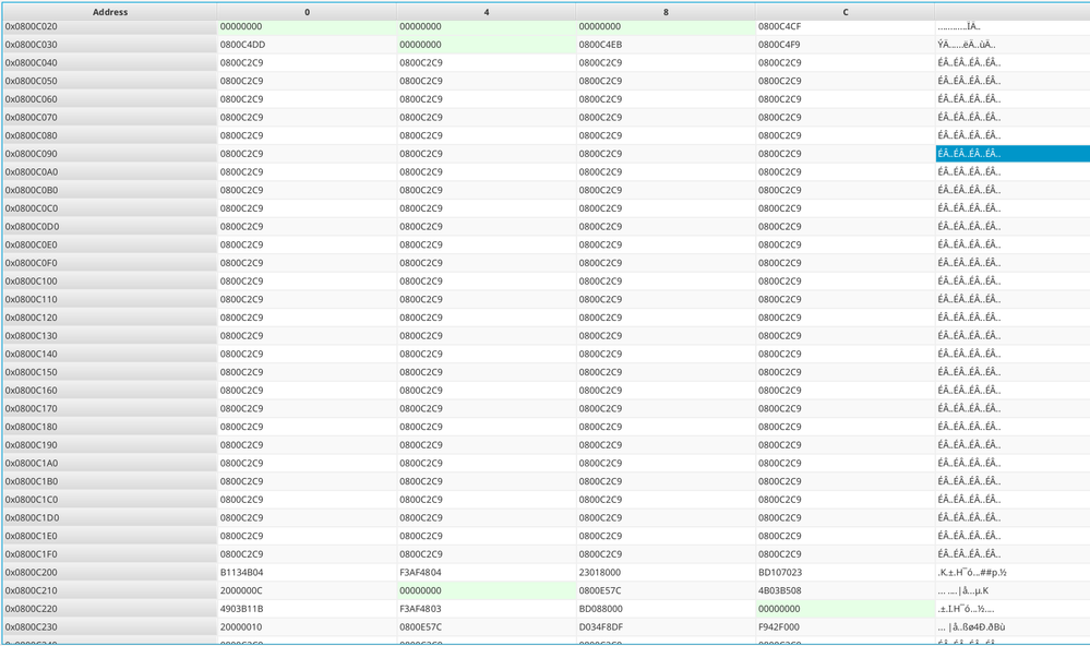

Greetings,
So, I am developing a bootloader, that receives a firmware, using a similar protocol to xmodem (128 bytes), through the USB. I followed this tutorial to implement the USB and adapted it to make it work on a B-U585I-IOT02A board. The USB communication works. So I am making something like this (some minor details have been omitted, but the big picture is here):

So, I still have a problem that the program is not jumping to the main program, but that's not the issue, the thing is, when I open the STM32CubeProgrammer and check the addresses I see some repeated information and I wonder if that's "normal".
The vector table, which is at the start of the program, typically has duplicate entries for interrupts that are not implemented as they all point to Default_Handler. That is normal.
