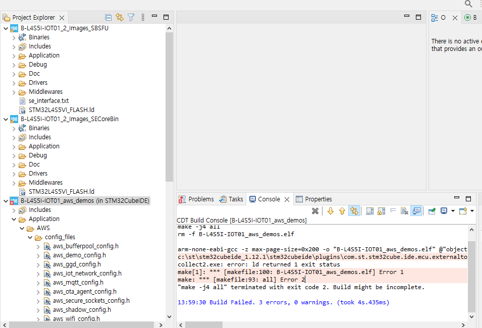

B-L4S5I-IOT01 보드를 사용하고 있으며, AWS Iot에 연결하는 과정을 따라하고 있습니다.
aws-demo 빌드시 오류가 발생하면 결함을 발견할 수 있는 방법이 도움이 되었습니까?
미리 감사드립니다.

Could you precise which X-CUBE-AWS version are you using?
Could you please check the build order indicated in the readme file?
Could please share the full error build message you received?

For now, I built it in the order of the build shown in the file.
And the X-CUBE-AWS version is 2.0.0.
And this is an error message that occurred when installing the aws-demos file.
>>> c:\st\stm32cubeide_1.12.1\stm32cubeide\plugins\com.st.stm32cube.ide.mcu.externaltools.gnu-tools-for-stm32.10.3-2021.10.win32_1.0.200.202301161003\tools\arm-none-eabi\bin\ld.exe: cannot use executable file '../../../../BootLoader_STSAFE/2_Images_SBSFU/STM32CubeIDE/B-L4S5I-IOT01_2_Images_SBSFU/Debug\se_interface_app.o' as input to a link
collect2.exe: error: ld returned 1 exit status
make[1]: *** [makefile:104: B-L4S5I-IOT01_aws_demos.elf] Error 1
make: *** [makefile:97: all] Error 2
"make -j4 all" terminated with exit code 2. Build might be incomplete.

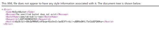

And I attached the wrong site that I am referring to.
I'm following the process on this site.
>>> https://master.d2s409snhlt74e.amplifyapp.com/
And this is the error picture of the additional installation code file of aws. ( No. 4 in the environmental configuration phase of Exercise 0)
