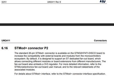

What is the pin pitch of each connector on STM32H747I-DISCO kit bellow. Pin pitch means the distance measured from the center of one pin to the center of the next pin.
・STMod+ connector
・Pmod connector
・ARDUINO connector
Thanks in advance.
Mike_ST
・STMod+ connector => 2mm
・Pmod connector => 2.54mm
・ARDUINO connector => 2.54mm for the shortest distance. But the 4 connectors implementation is exotic. Please check the CAD files here:
STM32H747I-DISCO CAD files

@Mike_ST The UM refers to these as "standard" connectors. It would be helpful if it gave links to the specifications.
More infos on those connectors:
STMod+ specification
PMOD specification
It would be good if that were included in the documentation of all ST boards which use these interfaces.
