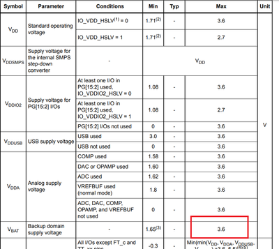

I was hoping to get some information regarding VBAT on STM32U5 MCU. I am currently powering the STM32U5 MCU with 1.8V (VDD supply). I need to have external clock oscillator for the Real Time Clock that is powered by VBAT (Coin Cell battery 3.0V). The external clock oscillator can be powered by 1.65V to 3V.
I didn't find any information regarding VBAT being higher than VDD. Will there be any issue with 3.0 V levels for the external clock oscillator for RTC? Or do I need to regulate the VBAT voltage to 1.8V for external clock oscillator?

Hello @Pahul_Singh ,
According to the datasheet there is no constraint regarding this point VBAT vs VDD:
VBAT max = 3.6V and not VDD.
