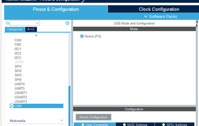

I use Win 11 and a Nucleo F303ZE (and a Nucleo F303RE, same problem), and y i need to use the virtual com port on the STM32 F303.
So, I try to enable the Virtual com port on the Nucleo F303ZE on th 2nd USB port (CN13) which is connect to PA11 and PA12.

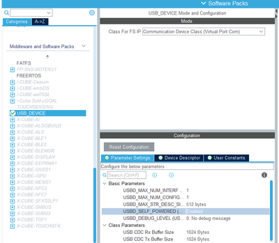

the USB_DEVICE config on STM32Cube IDE:
The USB setting:
Normally, it's ok. But, if i plug a (tested) USB cable on CN13 (which is plug to PA11 & PA12), or not, nothing happend on window. I see a Virtual Port COm, but it's the ST LINK. I do something wrong?

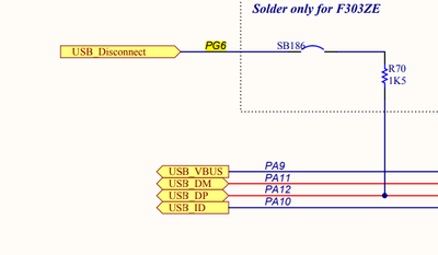

I found:
Set PG6 (USB_PowerSwitchON) to High (Low by default) and it works:
This part of the scematic gived me the clue:

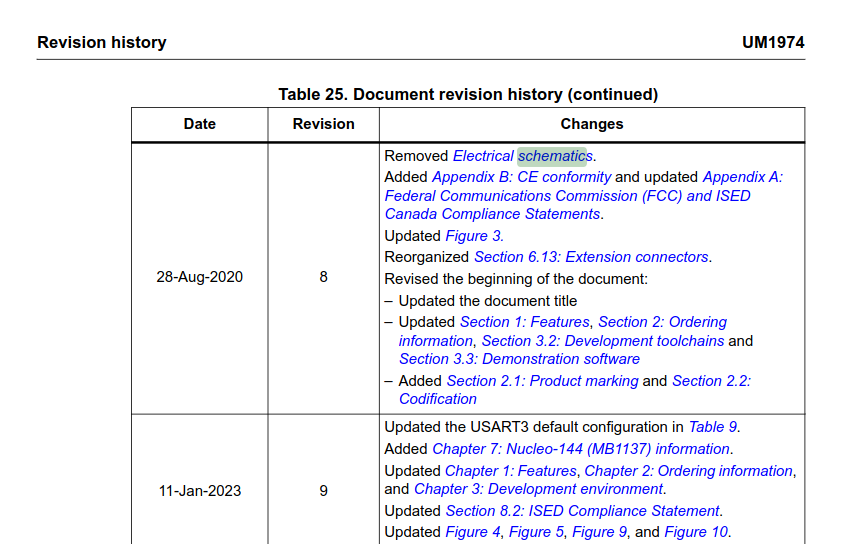

I tried to see the schematic of the board to try to understand how it works, but unfortunately the ST is going against the grain.
here is the schema:
BR

@le-gal.guillaume wrote:
here is the schema:
BR
Thanks, I opened a question about the schematic, now the schematics are available in the CAD Resources tab.

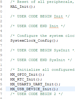

By the way, is it normal that USB_DP is at 0 after MX_GPIO_Init()?
The piece of code in MX_GPIO_Init() where  USB_DP switch to 0:
BR
I found:
