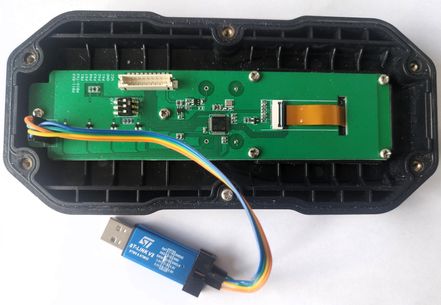

Using ST-Link v2 and Utility I've been trying to read and save a hex file from a EVSE device that uses a STM32F1 microprocessor to control and display functions. I thought that it was just a matter of connecting via the  debug/program interface and then saving the result, but unfortunately I seem to have erased everything and now the memory is displayed as empty.
My experience on this sort of thing is limited so can anyone help and possibly comment on what I'm doing wrong?

I'm not using a Blue Pill board. I thought that was for development purposes.
The photo shows my ST-Link connected to the existing board via GND CLK DIO VCC port.

That’s unfortunately not a genuine STLINK.
From what others have said, the fact that I disabled read out protection in Option Bytes caused the flash memory to be erased. Maybe this is more difficult to do in STM32CubeProgrammer with more warnings given, but it seems that if the code is read protected I can't do anything anyway.
