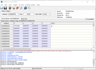

I use stm32f412 vet6.
Flash size is 512kbye.
But stm utility program is 1mbyte size.
Why??

The chip has 512 kB of FLASH memory that has been tested and verified.
Because it uses the same die as a chip with larger flash, it has additional memory beyond this. This additional memory has not been tested and is not guaranteed to work correctly, or exist on future versions of the chip, although there is a strong possibility that both of these are true. It is up to you if you want to accept the risk of using this additional memory in your projects.

512kbyte size  is 0x80000.
But tool is 0x100000.
Why???

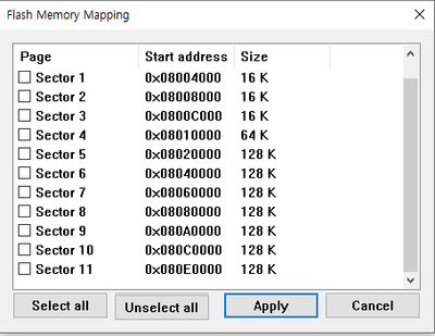

512kbye is 0x8000000~0x807ffff.
But sector is 11.
Why??
I tested mx program on stm32f412vet6.(512kbyte)
Whe i  generated iar 7.
Icf is 0x8000000~0x80fffff.→ 1mbyte
Why

I think because 512kB and 1MB devices have the same die.
512KB is physically 1MB but only the first 512KB is tested in factory.

IAR linker file is another story ...
Sorry i don't understand.
So can i don't use 0x80e0000?
I use 0x80e0000.
