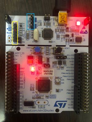

Removed the ST-Link plastic jumpers and all four pins are free now - as shown on the blue rectangle. As well as, the yellow rectangle shows the 6 pins of CN4 on one column.

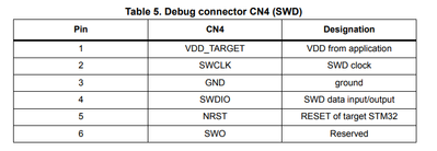

It seems that pins 1 and 3 are 3.3 V and GND respectively based on the use manual (https://www.st.com/resource/en/user_manual/um1724-stm32-nucleo64-boards-mb1136-stmicroelectronics.pdf) 
but when I check those two pins using a multimeter I get no voltage! Any idea where is the issue?

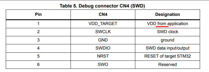

VDD is not driven by the ST-Link, but has to be connected to power of the MCU to be flashed/debugged.
This might be 3.3V or another voltage, depending on your board.
ST-Link reads this voltage.
Only if the jumpers are NOT removed then the ST-Link is connected to your MCU on the NUCLEO and VDD is delivered from there (one of the removed jumpers routes VDD).

My purpose is to make the connections below to use the Nucleo's ST-Link debugger for a code that's going to program the Blue Pill.
Nucleo ST-Link   |   Blue Pill
VDD_TARGET  =>   3.3V
SWCLK             =>   PA14
GND                 =>    GND
SWDIO             =>    PA13
NRST               =>     NRST
When I connect these, the blue pill's power LED doesn't turn on so it doesn't receive power from the ST-Link.
My board, as shown from the image in the first post, is Nucleo-64 STM32F411RE.
As @mfgkw said, and as shown in the table you quoted, pin 1 is VDD from the target - it does not supply power to the target:

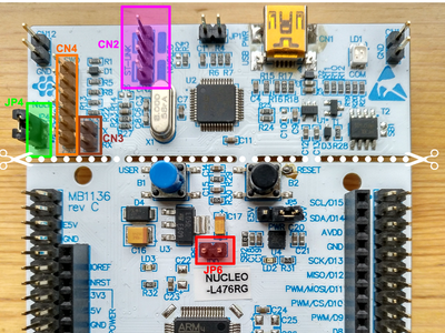

To be really sure that the ST-Link is fully disconnected from the STM32F411RE on the Nucleo board, you can break-off the ST-Link part:
Picture credit: @MM..1 via https://community.st.com/t5/stm32-mcus-products/3-3v-power-supply-for-nucleof103/m-p/657826/highlight/true#M240024

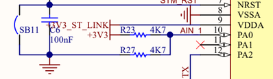

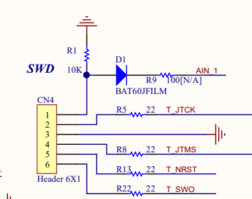

That's odd to me because the USB power is connected to CN1 of ST-Link part .
Not directly:

There is no need to break the board off.
- Remove the two jumpers
- connect at least VDD_TARGET, GND, SWCLK, SWDIO and NRST between your blue pill board with CN4 of the ST-Link
- if you need Traces via ST-Link then connect SWO as well
- power your blue pill board from any source
- power and connect the ST-Link via USB cable to the PC

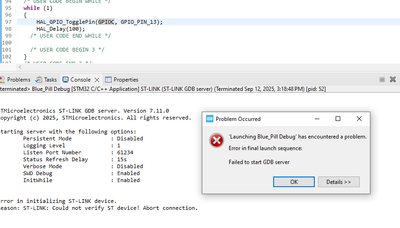

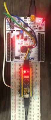

Created a simple project (just to toggle the onboard LED of the blue pill) and tried to run and debug it using the ST-Link.
Removed the two jumpers of ST-Link (CN2) and here's the wiring:
Blue wire: from 3V3 (blue pill) => pin 1 of CN4
Green wire: SWDIO (blue pill) => pin 4 of CN4
Brown wire: SWCLK (blue pill) => pin 2 of CN4
Yellow wire: GND (blue pill) => pin 3 of CN4
Wight wire: R (blue pill) => pin 5 of CN4
Both boards are connected to the PC using separate USB cables.
Now I get the error below when trying to run or debug!
What is the problem now!? :|

It looks ok for me.
But keep in mind that blue pills are regularely faked STM for quite a long time now. I have one here, which does not work with STMCubeIDE. It can be flashed with via hex file with STM32CubeProgrammer, but even that is not reliable. (It came in a set along with ST-Link clone, which does not work either...)
Black pills where usually better when they appeared. But I assume the situation with black pill is not really better meanwhile.
As long as you have no original STM product you will find not much help here. And to be honest it is wasted time to save a few bucks. Maybe you have more fun with real hardware. Switch to a NUCELO board or a naked CPU from a trustworthy source.
