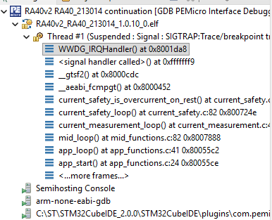

I have been developing a firmware to be used in the stm32g051. One of the features is the ability to respon to request to get information from the uC. I used dma for the uart1 tx and rx.  I was happily developing and testing the new feature added into the stm32g051. Then when I use it without the debugger, it is unable to stablish communications between the PC and the microcontroller.
The curious thing is the fact that I remove the debugger -I disconnect it- and the communication still works. It is the "reset" without debugger what is unable to stablish the connection.
I change the clocks following the several  post regarding this problem but the solution still eludes me.

Sounds like some timing issue in your startup: the startup will be slower in the debugger.
Instrument your code so that you can see what's happening during startup independent of having the debugger connected.

It is curious. I have never enabled the wwdg but it is being triggered.
So, again, instrument your code to see how it gets there.
Hi @carleslsregner
What you see in debugger could indicate that you are falling in an interrupt handler which is not defined. What I mean is the interrupt that leads you there is not necessarly the WWDG interrupt.
Regards
You can look at the VECTACTIVE field in the SCB registers to find out which interrupt it's in. Subtract 16 from the value and compare to IRQn_Type.
Pavel A.
The debugger screenshot hints that you're using semihosting. if so your program cannot run without debugger. Make a "release" configuration without semihosting.

I do not found the vector interruption but I isolated the problem module by module. It seems the code below is what causes the error. I didn't not found the error, but I found the solution. But yes, it seems related to the PVD (power voltage drop) interruption.
