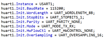

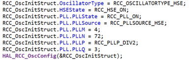

I ran the example “F429_DISCO1_UART_Print” and successfully displayed “Hello World” on Tera Term.
Then I tried to port this project into my own one (which is a camera project).
However, the result was garbled characters in the terminal.
The baud rate (115200) and PLL/clock configuration are the same as in the working example.
Do you have any idea what might cause the characters to be corrupted?

Fig.2 PLL configuration
Fig.3 Baud rate (115200)  on Teraterm
Fig.4 Baundrate on project
