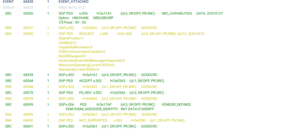

Problem - is i'm getting stuck with the current example.  It gets stuck at SVDM_deiscovery_identity part.  Which in that packet i should be able to start to tell the host that i have display port capability, but i what is currently set it that the message is unsupported.  How would i go about enabling this.
Thoughts - In usbpd_vdm_user.c it seems like it has all the stuff that i need to start sending back these kind of messages but they don't seem to be called anywhere.

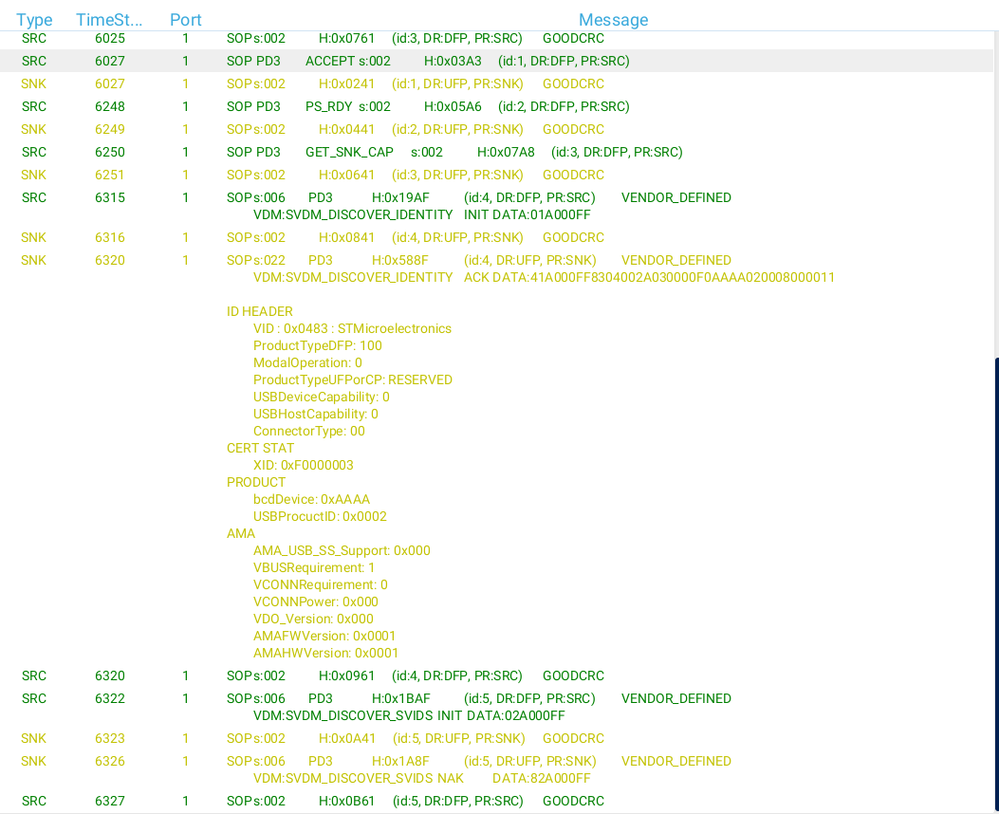

Capture from  a STM32 PD G0 - with STM32CubeMonitor app

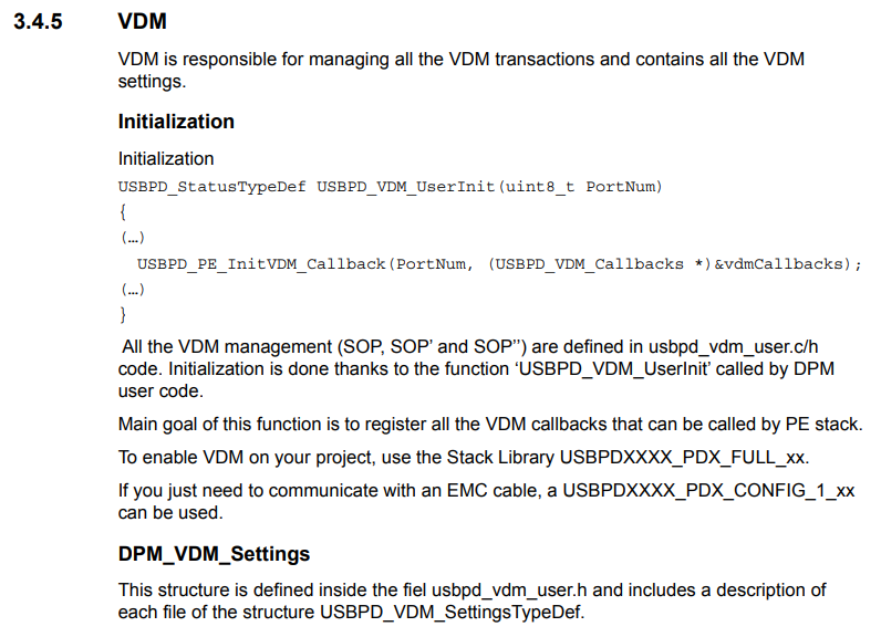

  • In usbpd_dpm_userr.c, you need to init USBPD_VDM
USBPD_StatusTypeDef USBPD_DPM_UserInit(void)
/* USER CODE BEGIN USBPD_DPM_UserInit */
USBPD_VDM_UserInit(USBPD_PORT_0);
  return USBPD_OK;
/* USER CODE END USBPD_DPM_UserInit */
  •  in usbpd_vdm_user.c you need to actually setup the callbacks for this subsystem
USBPD_StatusTypeDef USBPD_VDM_UserInit(uint8_t PortNum)
/* USER CODE BEGIN USBPD_VDM_UserInit */
  USBPD_PE_InitVDM_Callback(PortNum, (USBPD_VDM_Callbacks *)&vdmCallbacks);
    return USBPD_OK;
/* USER CODE END USBPD_VDM_UserInit */

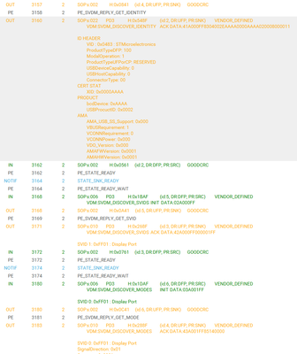

At this point you'll need to start defining some of these objects and looking at the eval example will help a lot with it.  At this point mixing most of the code in the usbpd_vdm_user.c from the eval project my usb monitor program looks like this.  Which was huge!  You can see the SNK send back a SVDM discovery identity packet!
Documentation that was really helpful
From the software stack guide

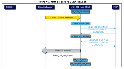

About USBPD_VDM_DiscoverSVIDs API is called to retrieve SVID supported by device and answer to SVDM Discovery SVID init message sent by port partner

What i'm trying to currently figure out is how to to setup this software so that it supports a SVDM_DISCOVERY_IDENTITY response.  In the image from the first post you can see it replay's with a NOT_SUPPORTED response.
