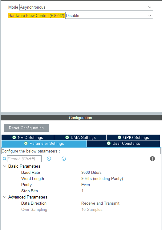

Can you please share the pictur of uart setting ioc? Are you using 8 bit or 9 bits data?
9 bits and before to you say it i have tried other configuration too with 8 bits also and gotten the same result
