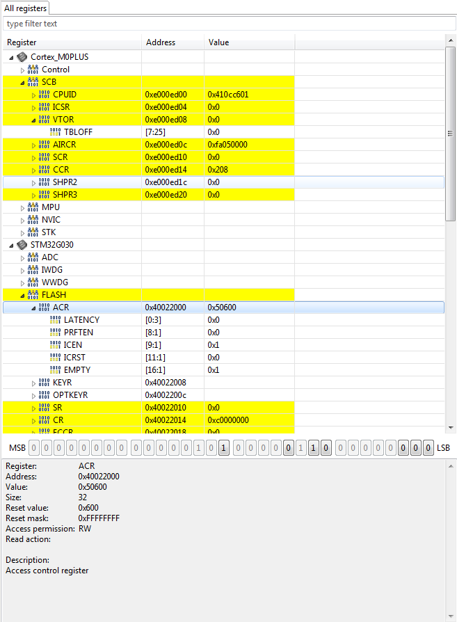

2) If you run any program (without any interruptions - this is important), then everything works fine, the program is executed, debugging works, it stops at breakpoints. When debugging is disabled, everything continues to work.

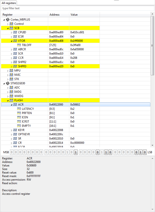

3) If you configure at least one any interrupt (I tried it from ADC, DMA, TIM), then something unknown happens. As soon as an interrupt should occur, the program jumps to >0x1fff0000 and stays there forever. Next, I spent a lot of time reading about how interrupts work. As I understood from the documentation:

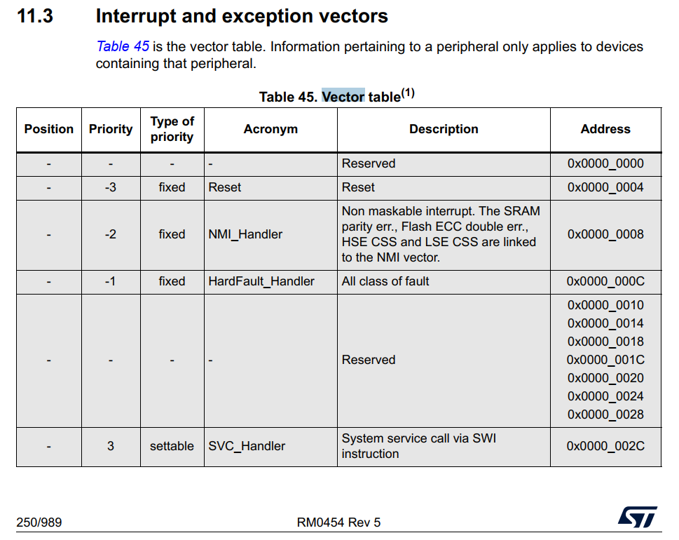

There is a table of interrupt vectors. RM0454 Rev 5 page 250/989
0693W00000aH7HWQA0.pngWhen and how it is written, I did not quite understand, but as I understand it, it is written to the address that lies in the VTOR register

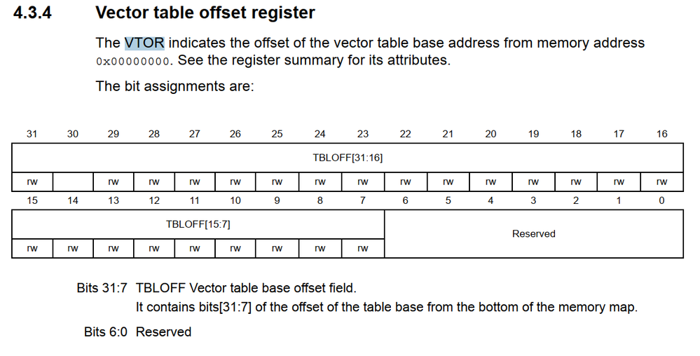

0693W00000aH7HbQAK.pngIn the end, I put a breakpoint before starting the interrupt and looked at this register
0693W00000aH7HvQAK.pngI saw 0 there, which seemed strange to me ... It turns out that the addresses of the interrupt vectors are from address 0?
Next, I unpaused the program so that an interrupt occurred and also hung on the address space> 0x1fff0000, but if you pause in the VTOR register, it will already be just 0x1fff0000. Coincidence? Don't think. I also noticed that in FLASH the Latency register was set to 2. I don’t know what this is connected with, but it’s a fact.
0693W00000aH7IUQA0.png4) I realized that all this goes away not when I set the read protection, but when I write to the last page of the flash memory. What can happen that the controller goes into such a state?
