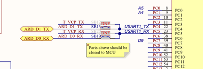

@mƎALLEm wrote:
on NUCLEO-G474RE, VCP is connected to USART1 and you should solder SB12 and SB20 as I stated previously.
The User Manual says LPUART1 by default, or USART1 by changing SBs ?
Screenshot above.
@Andrew Neil wrote:
Screenshot above.
In fact, it could be both (USART1):
or (LPUART1 the default configuration)
He needs to play with the solder bridges.
Meanwhile, @mpek29 you can use the printf example provided by the CubeG4 over this link:
https://github.com/STMicroelectronics/STM32CubeG4/tree/master/Projects/NUCLEO-G474RE/Examples/UART/UART_Printf

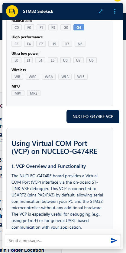

@Andrew Neil wrote:
@mpek29 wrote:
 I've gathered that it’s possible to achieve the same functionality using UART2 instead for the NUCLEO-G474RE. .
Where did you "gather" that?
@mpek29  Did you ask ST's AI assistant, "Sidekick" ?
It does say UART2:
But that is wrong!
PS:
This is due to out-of-date information in AN4989: - see here.

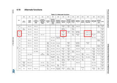

waclawek.jan
USART2 can be used at PA2&PA3 in the same way as LPUART1 can be.
Something has probably got lost in the clicking.
Debug as usually, by observing all relevant (RCC, USART, GPIO) registers' content (assuming you've checked the hardware already - pins connections, clock) and observing the waveforms on given pins using oscilloscope/LA.
